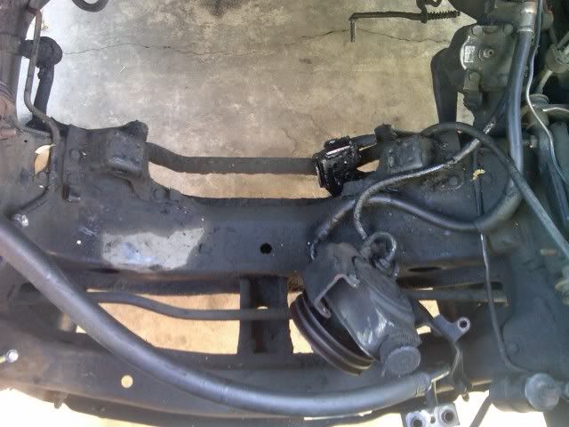

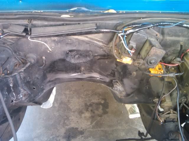

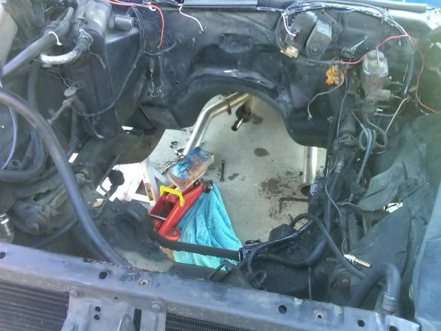

now that the engine is pulled and everything else removed, i finally have a chance to clean up the engine bay :yes: only problem is i have no idea where to begin lol..any pointers guys? here is how it sits now
#6 ·
mmm sounds like its pretty easy then, gotta buy some degreaser or something like that to start spraying it and wash it off..any idea on the paint? where do i get some or whats best?
First thing I'd get rid of is that expanding foam in that one hole!! Next I'd take the time to remove heater hoses, power steering lines and the coolant recovery tank. Clean those up, clean up the wires with looms of some sort.
Get it all out of the way for some major power washing of the engine compartment. I have used cheap generic spray oven cleaner and a water hose to remove heavy grease build up. Careful of the fumes, so a ventilator and outside for that. Simple Green works well with cold water also.
Make sure it sits to dry for a day or two to dry before painting it. You'll be surprised at how nice you can make it with minimal spent and a little time to organize things neater.
Good luck.

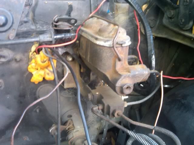

your telling me, ever since i got the car that nasty azz yellow foam crap has always stuck out..any idea what to fill that hole with? it has 4 or 5 wires that come out of there so i cant complete seal it, i might run all the wires throught there that are from the engine bay that go inside, just to give it an even cleaner look..guess ill start by removing the hoses since that's all there is to remove
http://www.jegs.com/webapp/wcs/stor...10002&langId=-1&Ntk=all&Jnar=0&Ne=1+2+3+13+1147708&searchTerm=firewall+grommets
If the link does not work, search "firewall grommets" @ Jegs
Sean[/QUOTE]
o dang sweet!!! exactly what i need to fill it up..thanks, now i just gotta determine which to get :yes:
